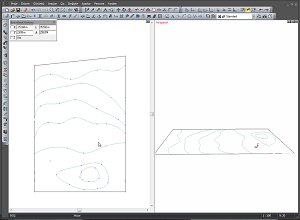

Ms. Arzu, thank you very much, the training videos you have prepared with a lot of effort are very nice. I ALSO PROMISE TO THE IDE TEAM FOR UPGRADING THE PROGRAM'S QUALIFICATION SO MUCH. I have only one question on this subject, do we have the opportunity to give slopes to the gaps?
terrain modeling excavation etc. accounts can be reported. plot area according to the entered coordinates, void area/areas, excavation-fill volumes... their drawings/sections etc. according to the entered coordinates. should be. even as a step forward, soil types (according to the excavation pose) should be defined. thank you.
